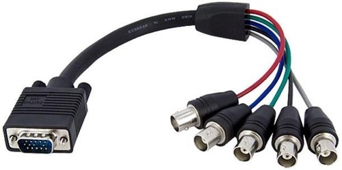

I'm thinking to combine these cables for the monitor:

That'll work. The cable I made has 5 BNC on the other end, not a VGA connector like the project notes.
