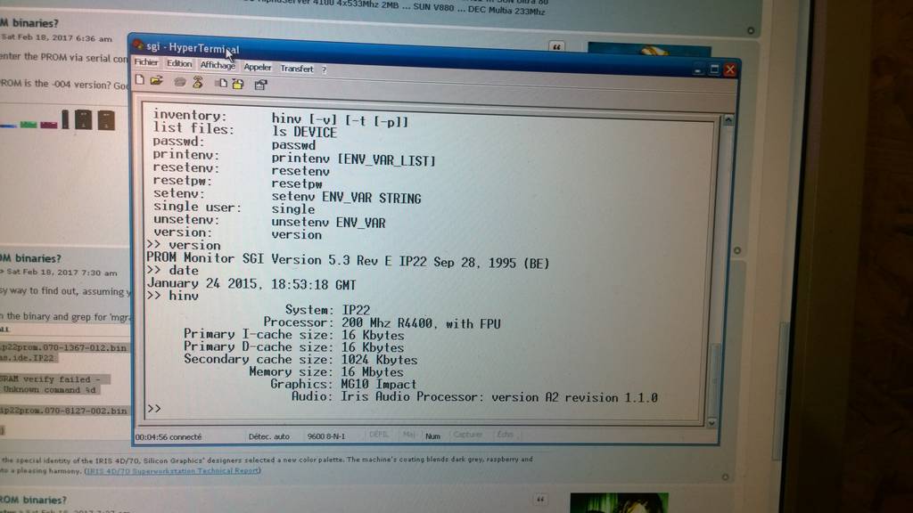

...Fortunaly no, i haven't got a DIN8 to DB9 converter. (A shame, i'll made one or found one ... Seem to be a sun DIN plug)
It's very strange.
In all Indigo 2, i presume, the frame buffer post on just before switching the green led (after amber and chime).
My working impact post on (blanck screen but synchro) after the last green led...
The couple, CPU/ram/mobo seem to be OK... And work like a charm with an old extreme stack.
Does my PSU have a too low 5V extrenal rail??? (dawn, i just recaped it with new capacitors)
I have try with the last revision V12 dump, but the mobo won't chime (!)... corrupted dump???
PS: yep, the C revision seem to be 004... ^_^

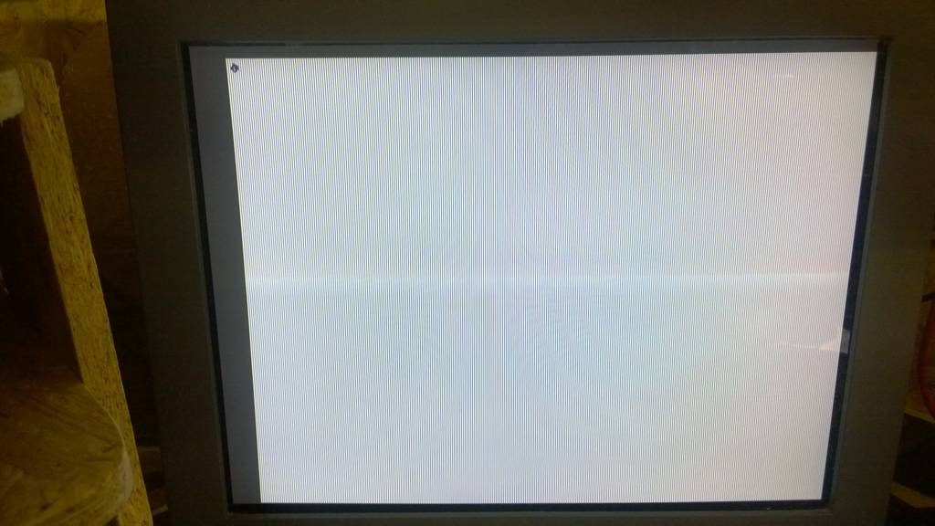

Re: SGI PROM binaries?
Unread postby jammaster » Sun Feb 19, 2017 9:03 am
Made a cable.
The Indigo seem to work headless ... But my Solid impact post nothing (!) ...
I don't think it's my monitor, my other indigo 2 maximpact work great on it!

jammaster
Posts: 117
Joined: Fri Nov 06, 2015 9:47 am
Location: France / Lyon
Unread postby jammaster » Sun Feb 19, 2017 10:42 am
Diganostic passed in console mode.
The only time i have seen this hybrid config posting!
Next step??? tree ... rope ...
