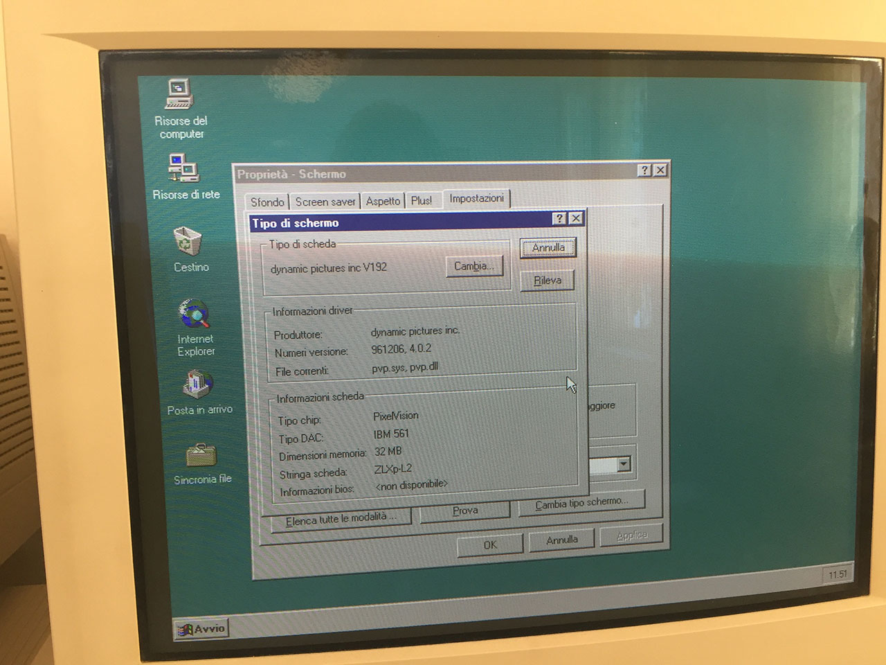

Unread postby marmotta » Sun Aug 06, 2017 3:02 am
With my pentium133 the board work good! :D
