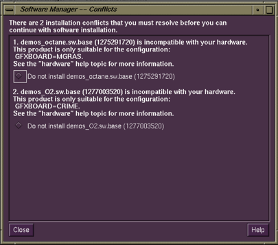

hello,
after scouring everywhere for the demos and finally getting ahold of a seemingly complete installer set, i am still getting this:

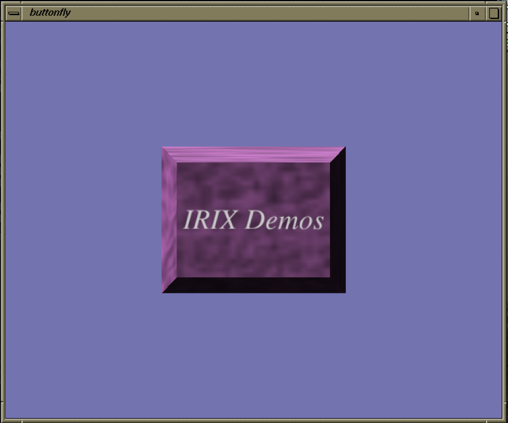

buttonfly also only show this in the 'trees' section:
now it would be perfectly logical if i could only install generic demos and stuff for the ODYSSEY card.. but i have seen in dozens of images and videos around the net that people have all of them installed. so what am i missing?
cheers,
bamdad

bamdad wrote:so what am i missing?
You'll need to invoke the rulesoverride option in SoftwareManager before starting your install.

grr i always forget about that. thank you, works fine now. :)
